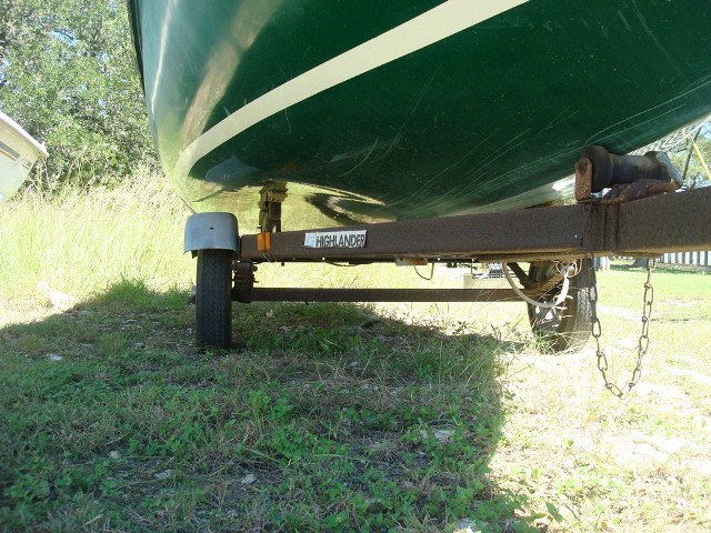

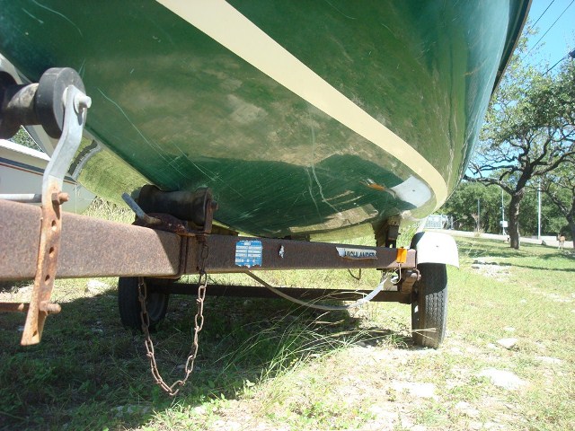

Postby Zinger88 » Fri Sep 30, 2016 12:21 pm
I'm a new member to DaySailer.org and currently in the market for a Daysailer. I have the opportunity to acquire this 76' Daysailer II but would like thoughts on the hull deflection shown in the attached photos. Boat has been sitting on trailer for extended period of time. Is this something I should be overly concerned about? Will deflection resolve itself once pressure is taken off when boat gets in the water?
Thanks in advance for any advice you guys may have!

My guess with my limited knowledge would be that it should spring back, off of the trailer. That being said I would strongly suggest that you replace the bunks on the trailer with wider and longer ones. I went with 8' 2x6 covered with the appropriate carpet. My DS III sits much nicer now.

If the rollers have given way, then more of the load is on the bunks. This is what happened with my boat, which showed a similar degree of deflection. The bunks are really there to maintain lateral stability, more than bear most of the load, this as described in the instruction manual. It may also be that the PO adjusted the bunks too high.
If there are obvious problems, like cracks or crazing radiating away from the bunk contact area, then pass, otherwise, I would not worry about it.
Usually the bunk contact edge is square (horizontal), while the hull is at about a 10° angle, which means the bunk makes only a line contact with the hull. You will probably want to replace the bunk carpet when the boat is in the water. You can then use a hand plane to make the contact edge of the bunk match the angle of the hull.

Postby Solarwinds » Fri Sep 30, 2016 5:10 pm
From your pictures, there doesn't seem to be any oil canning on the port side of the boat, but the forward side of
the depression on the starboard side looks almost like it's creased.
Maybe I can't really tell from the picture, but that, to me, is a little extreme.

Solarwinds wrote:From your pictures, there doesn't seem to be any oil canning on the port side of the boat, but the forward side of
Probably just an effect of the asymmetric distribution of light and shadow around the boat. If the photo showed a straightedge it might be possible to gauge the deflection, but not this way.

Postby hsubman » Fri Sep 30, 2016 6:22 pm
The boat seems to be a little off-centered on the trailer. The keel seems to be to the extreme right edge of the center rollers. That is placing the starboard bunk more towards the bottom of the hull while the port side bunk is up higher on the hull. this would make a great difference in weight distribution on the bunks. If possible, I would try lifting up on the stern and try to slide the boat a little left to center the keel on the rollers. Could make a difference. Just a thought.

I got a new trailer for my 76 a year or two ago. I had the new bunks adjusted as high as they would go and the hull was still resting on the keel with an inch gap to the hull. The hull relaxed down to the bunks within 2 days. At a minimum, upgrade to 2x4s on the flat rather than the edge. I would think that if there are no major cracks in the gel coal, your hull will relax too.

Postby Zinger88 » Fri Sep 30, 2016 9:49 pm
Thanks everyone for your thoughts and insight. The current owner sent me the photos and I'll have an opportunity to inspect the boat in person next week. I will certainly check for cracks around the deflection and will also attempt to center the boat on the rollers and then see if anything changes. Should I purchase the boat, first upgrade will definitely be new bunks.

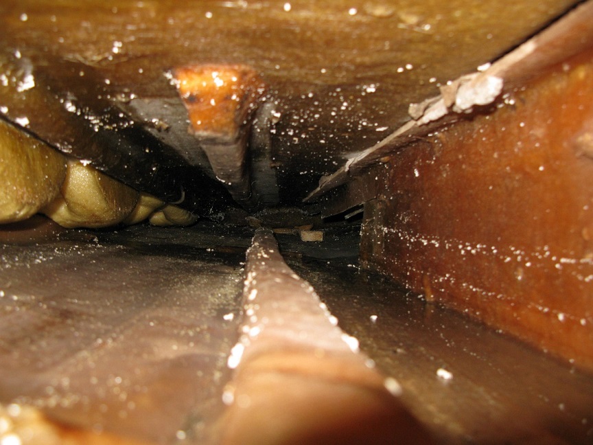

Postby jeadstx » Mon Oct 03, 2016 1:38 am
This what it looks like in inside the bilge of a DS II (picture from my 1976 DS II, starboard side looking aft). Picture was taken through the inspection port prior to stuffing with "pool noodles".
DS II Starboard Side - Looking Aft.jpg (177.42 KiB) Viewed 17666 times
Re: Hull Deflection on 76' Daysailer II
Postby GreenLake » Mon Oct 03, 2016 1:41 am
The stringer is intended to limit flexing, but only in one dimension. If you place a narrow bunk under it, there's nothing that would limit it from being pushed up. Nothing that is, other than the hull laminate.
