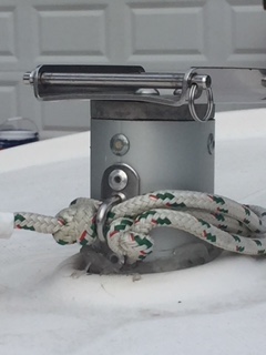

Postby dpatrick » Fri Oct 27, 2017 12:43 am
So... the bottom plate of my mast hinge is pretty deformed. Wondering if anybody else has had this issue? I’ve tuned the rig to the North sails guide and it’s pretty snug. I don’t know if the plate is fatigued( I did bend it back up flat) and it bent right back after the next time sailing. Maybe it happened before I got the shrouds tuned properly? Or maybe after? I’m stumped and need to replace the bottom plate. I’m just hoping for some insight before I replace with a new one. I’ll get a picture of it as soon as I can.

Also Finally getting some photos of the bent plate

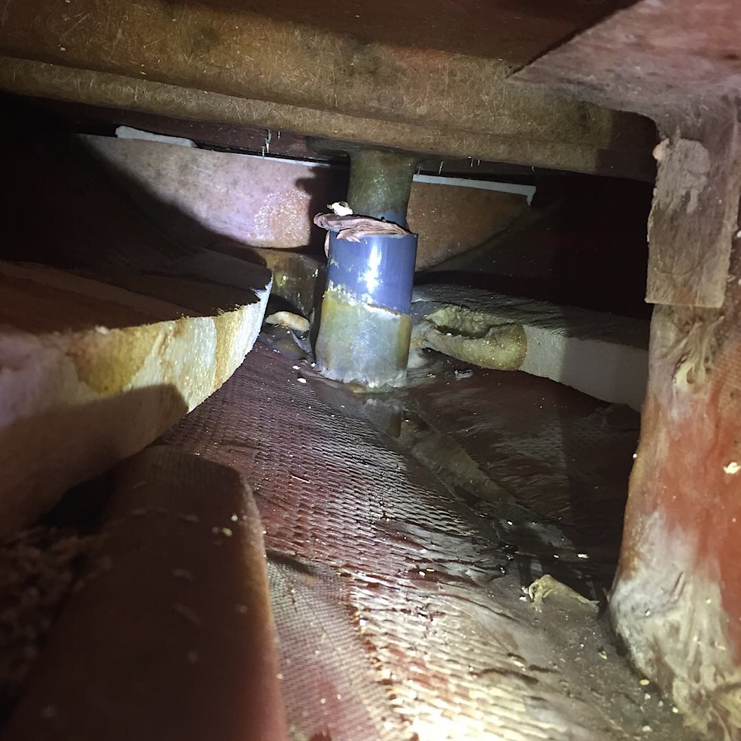

Postby dpatrick » Tue Apr 24, 2018 8:20 am
After getting everything rigged for the season, I noticed when the rig is tensioned, the mast lowers maybe 1/4” or so. It would seem the compression post has a little give. Took a pic of the post under the floor and can’t really tell if it needs repair or not. Should it really compress or is it supposed to be completely solid?

Postby Alan » Tue Apr 24, 2018 1:24 pm
There shouldn't be any give. If the top of the compression post were free to slide up and down in the bottom, the base of the mast would be supported only by the cuddy floor. Since a properly tightened rig is very tight (there are threads about rig tension elsewhere on the forum), this would put a pretty big load on a sheet of fiberglass.
The easiest way to check would be to pull the mast up and out of the cuddy, climb partway in, and push on the cuddy floor directly above the compression post, where the mast rests. If it flexes, there's your answer.
Another possibility, that's happened to a couple of people, is that the compression post is misaligned with the bottom of the mast, so the downward pressure of the mast is not directly on top of the compression post.

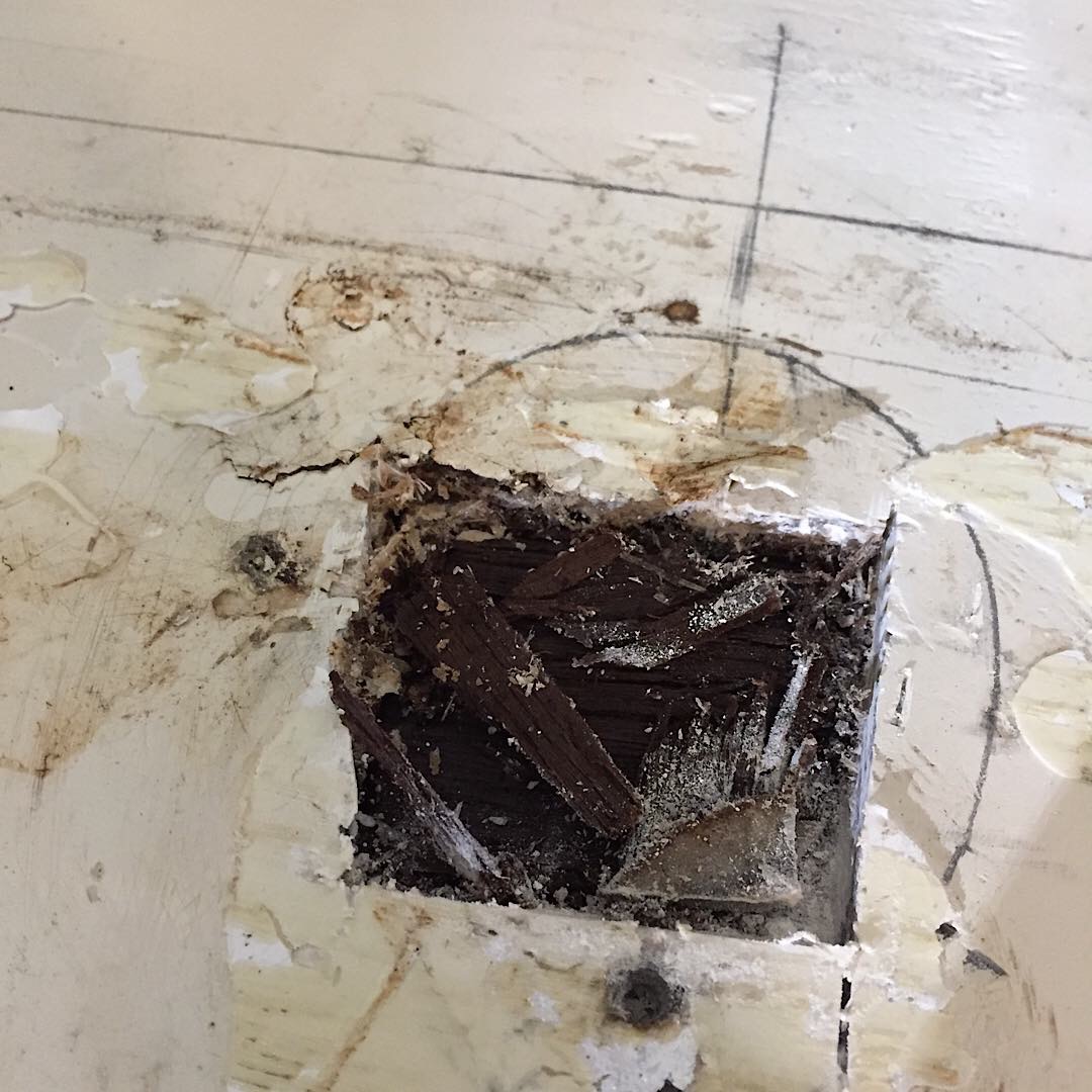

Postby dpatrick » Tue Apr 24, 2018 2:47 pm
After reading some other posts about this, I am guessing the plywood under the glass floor is rotten, or gone. When I bought the boat five years ago there was an oak plate under the cast aluminum step. I replaced it(unfortunately with 5200). I never considered there would be any more wood under the floor. So yeah, when I attach the forestay under full tension I can see the tabernacle go down probably at least a quarter inch maybe more.
To clarify... the compression post is pvc pipes? if so that seems silly! then plywood backer, glass floor, then I’ve got an oak plate, then the aluminum step. Looks like my oak plate is doing a good job of hiding problems underneath.
And I have my rig tensioned pretty high, not as high as the north tubing guide ,but close!

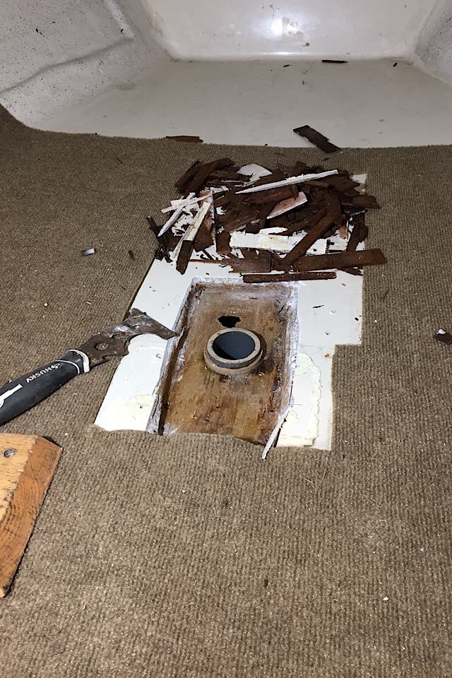

Postby dpatrick » Wed Apr 25, 2018 12:09 am
What I found
dpatrick
Posts: 34
Joined: Mon Jun 01, 2015 6:39 pm
Re: tabernacle plate bending
Postby dpatrick » Wed Apr 25, 2018 12:10 am
All cleaned up and ready for repairs
dpatrick
Posts: 34

Postby Alan » Wed Apr 25, 2018 12:38 pm
Interesting. I didn't suspect there would be plywood under the floor; I figured the flange at the top of the compression post was all there was. Maybe I need to take a closer look at my boat.
That's a nice setup, by the way, with the battery box firmly secured and the wood reinforcement for the centerboard line attachment.
How much fun was it to undo the 5200?
Postby dpatrick » Wed Apr 25, 2018 2:14 pm
Surprisingly the wood came off pretty easy.
The plywood has me puzzled as well, maybe it’s to give something to fasten the step to, and the centerboard hardware. Or maybe as some have suggested to cover in discrepancies in placement of the compression tube.
I’m considering filling the void where the plywood was with chopped mat and filling it all with glass.
On a side note, the comp. post is accurately at the 11’ mark from transom to post. My mast was clearly not or just barely touching the the back of the post. There is enough movement to set the mast on the post now, I’m just not sure if I should try moving the mast base forward or not. Obviously that will change rig measurements if I do. I know my mast also is 24’ 2 1/2”, oday brochure says mast height is 24’ 11”. Now that is the Ds1, which doesn’t have the second floor, so it’s all a little confusing as to what the height should be. In any case I want to set the rig to have proper mast rake, which it didn’t have at all before all of this, so i’m inclined to nudge the mast step forward a little and see how it all works out, I can always move it back if I need to( but I’d really like the step to be supported on the compression post).
To backtrack a little, When I replaced the oak under the step, I made sure to measure everything and put the mast exactly where it was, knowing what I know now, I couldn’t be sure the p.o. who put the wood in there actually put it in the right place. It would be really helpful if there was a consensus on the measurement from transom/deck edge to the back of the mast step. My friend’s DS1 is 11’ exactly. Sorry if I’m rambling on too long!
