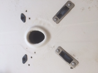

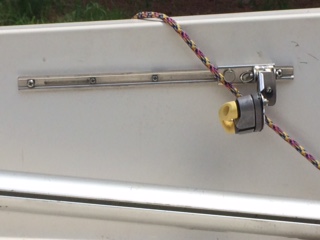

I've searched the forum and can't find the help I need. If it's out there please point me to it. I bought a derelict DSII at auction and am in the process of restoring her. I cannot identify what the previous owner used for jib sheet blocks and cleats. The attached "jib cleat" photo is of my friend's DSII. Is this the preferred location and type of hardware? My DSII has a large ratchet block on the same type of track in this location. Unfortunately these were backed by rotten wood which had been glued and screwed on but the screws easily pulled out. There are jam cleats 5 or 6 feet aft of these. Were these blocks and cleats for a spinnaker? The other 2 photos are of various hardware on my boat. The two holes forward of the hole for the mast had turning blocks and cleats on wooden "risers" under the cabin roof. The turning blocks aft of the hole have no cleats near by. I suspect these may have been for halyards and possibly a topping lift for a spinnaker. The port side of the cabin opening only has the two upper cleats.

In the second photo, the upper cleat is probably for a barber inhaul (aka barber hauler), used to bring the jib sheet inboard.
In the bottom photo, the jib sheet track is in the original location, with a new-looking cleat/fairlead attached. Opinions differ on whether that's the ideal location.

spinnaker controls vary widely, as many were put on after the fact by various owners.
+1 on the suggestion re: inhauls. You rig them, so they cross over, that way they can be set from the rail as you are hiking out. (You only use them sailing upwind).

Regarding the cleats on the bulkhead, they are all installed to keep the line from moving inboard. Wouldn't they need to be the other way for use as barber haulers? I'll leave them as is for a while. I will remove them later if I don't find them useful. I hope to have the mast step repaired this weekend.

I read somewhere that the original Barber haulers were in fact outhauls, we tend to use the name by analogy for inhauls as well. On the DS, they are definitely rigged as inhauls (by those who have them). However, as I wrote, you tend to mount them so they cross each other in the middle of the deck, with the cleat for each Barber inhaul on the windward side and the block at the end of the inhaul at the leeward side. That's why the cleats seem to be positioned the "wrong" way around.
This is done because they are upwind controls and you operate them when you sit on the high side while going upwind (and the active jib sheet would be on the low side).
1841
Mine aren't mounted as far out. The picture shows the starboard side of the boat, with the line leading to port (angled downward from the cleat on the left) being the inhaul. The other one is seen in the bottom of the picture. (They both point down because we aren't going upwind and everything's slack. Otherwise they would lead level or a bit upward).
I can usually just reach them when I need to, but a setup with cleats further out like on your boat is better. (We are talking about the small cleat that would be top-most in your picture if it was rotated to be upright).
(I have no idea what the other two cleats might have been meant to accomplish.)
