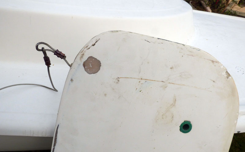

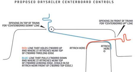

I recently purchased a '73 Daysailer II (hull #6822) and have one issue that requires advice... the centerboard pennant/controls. After launching her for the first sail, the centerboard would not lower. There is a centerboard pennant (hold the board up line), made of stiff shroud material (1 x 19 wire) but it is quite contorted and bent. There is, however, no line/pennant for lowering and keeping the board down; although there is an opening (with small block) in the top of the centerboard trunk that appears to be for such a line. First, do Daysailers normally have both a "keep board up" line and a "keep board down" line? Second, is the attachment of the centerboard lines/pennants as shown in the accompanying photo standard? Third, I've made a quick drawing to show how I propose to install new centerboard control lines to solve the problem... would you anticipate any problems with the proposed scheme?
Thank you very much for taking the time to help a new DS sailor.
Dana Dahlquist
Proposed installation of c'board controls.
Existing c'board pennant attached to top of c'board trailing edge.
c'brd top e.jpg (62.58 KiB) Viewed 18073 times

Dana, welcome to the forum.
I'll push your post to the "DSII Only" section, where we have all the other posts on the DSII centerboard installation. (Look around, you may find a lot of older discussions of this topic with diagrams and pictures).
Hopefully one of the DS2 owners will chime in with a comment; I'm not really qualified having sailed one for a few days but never owned one.
I do know that both lines are standard for a DS. This is because the CB is not weighted. For boats with a weighted CB, you may only need the uphaul.

Hi Dana,
I dealt with this a while ago. There are many different pictures if you look around this BB. I wound up with a block attached under top of cuddy with a 2:1 pulley.
I don't have a photo to post, but I ran line down to hole in bulk head and then aft. It's very similar to Tim Webb's gallery/image_page.php?album_id=100&image_id=2394&sk=t&sd=d&st=0
gallery/image_page.php?album_id=100&image_id=1568
Specific recommendations
1. A snap at top so you can detach it when not sailing. Makes crawling around the cuddy easier.
2. Rig a continuous line from down haul to up-haul looping through cockpit. Tidier.
3. Write up and down on bulkhead unless your memory better than mine.
4. BC I sail in shallow waters, I use a quick release cleat for downhaul and a clam cleat for up haul. I hear a scrape and then POP - up comes the cb. at least partially. Check this out : https://www.youtube.com/watch?v=YntnL6yUGqU

Hi Dana, my setup is the same as the one that Tipster described and linked the photo. Do you already have an exit hole for the CB uphaul where you are proposing in your drawing? I can't remember if all DS IIs had them in the same place. My only concern about your diagram is whether you might have less leverage when the board is up than if the hole is all the way forward. In ours, I find that getting the board initially started from the up position is what takes the most work by far, so I wouldn't want any less leverage in that position than I already have.

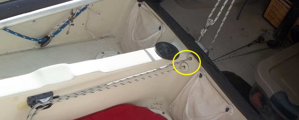

Got my CB reinstalled and boat launched. A little trouble lowering the board the first time, but after a friend went swimming it seemed satisfactory. Upon return I noticed that the round thingy (see below) on the cuddy side through which the cable goes was cracked. Also when we set out, the doubled-back end of the cable was jammed into said round thingy. I tried to pull it out but gave up. It must have cracked with the force of the CB being released back to the down position.
What do you call the round things that line the centerboard pendant through holes?
. . . circled yellow in this clip of one of Tim Webb's pics ... I assume that the ones in this photo are the same as the ones on the cuddy side.
And, can I buy them at a place like WestMarine or Defender (Waterford CT) or is this a special thing I should get from Rudy (D&R)?
Seems like this part is not essential but would definitely protect the bulkhead from banging and accompanying deterioration.
what do you call the round things circled yellow?

Thanks, GL. Rudy calls them "doughnuts" ... and says they could also be called bushings or fairleads.
Shaeffer no longer makes them. He says that WestMarine sells something called a half-inch plastic "through-hull" for $7 that will do the trick ... all I need to do is cut off the top.
Reading my DSII manual a little more carefully this morning, I see that Roger Conrad talks about replacing "donuts" with one-inch plumbing nipples in his section about Uphaul holes (pp85–87). The process involves threading the hole "with a one-inch steel pipe." ("Use an ABS nipple with a nut on the end.") He says that the swaged end of the cable will pass through this diameter without difficulty and facilitate future removal without having to remove the tang. Once installed, he says to "Add a brass plumbing cap to the nipple and allow the wire to run through a 1/8" hole drilled into the cap's center." Interesting. So maybe learning how to tap a thread is in my future . . . .

Just to clarify, it was the donut on the cuddy side that broke. (The clamp on this end of the cable was jammed in there.) The photo I posted was really just to ask what you call the darn things.... (I didn't keep looking to get an image of the donut on the cuddy side.)
