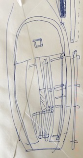

I was planning in doing a complete re-paint of the entire boat next year, so this doesnt add too much work. For the undamaged areas, some light sanding before painting should be all that is needed... correct?
The cockpit and decks have some spiderweb cracking in spots, and mild crazing. I plan on drummeling them out, filling the hole/channel, fairing it down, and repainting the entired surface. Im also thinking of installing some wood strips on the flooring and seats. See attached. From what Ive seen, my plan would be after refinishing the topside, to install the assembled flooring and seating by glue/ adhesive of some type. The assembly would have perpendicular supports to the wood slats running lengthwise of the boat that would make up the flooring and seating. This may be done at a later date depending on how long all the finishing goes.

Postby GreenLake » Sat Jul 27, 2019 12:33 pm
The light sanding seems about right for places where the gelcoat is still good.
Your other plans sound like you are trying to make the DSII into a DS1 (with all the woodwork).
The difference between the two versions of the DS is that the seats in the DSII seemed shallower to me. If you put a wood grating in the footwell of your DSII you'll exacerbate that effect. And you would be adding a not inconsiderable amount of weight. (I took my floorboards out of my DS1 to refinish them, a project that stalled for various reasons, and I've been sailing it for several seasons now without. Certainly didn't hurt our boat speed; I had to rig a replacement shelf for the cuddy floor, though, or all my bags would sit in the bilge, which is not ideal - not an issue for a DSII).
But, that said, your plan looks doable. Just be sure that you can get each piece into the boat (there are some subtle curves; I would do a mock-up of the big piece, for example). You don't need to glue anything for the floors, gravity holds them quite well - at least until you capsize, and then they'll float.
For the seats, I would propose something quite different. When I sailed in a DSII for some extended cruising, mostly going downwind, I found seating not very pleasant. The boat was rigged with a plank that could be used to turn the space between the seats into a sleeping platform. We ended up placing it crosswise near the middle part of the aft end of the cockpit and I could sit on it facing forward (or more forward) and it was slightly raised, giving more room for my legs. My friend ended up mostly leaning on the cuddy bulkhead, facing aft.
For the few upwind stretches, we both sat on the coamings, not the seats, so any permanently installed seat backs higher than the coamings would have been in the way. I've sailed my own boat decorated so that you could not sit on the coamings and was able to pull that off only because of superior crew weight and light winds.
832
So, if you are looking for comfort, I'd look into making two "chairs", simple L shaped contraptions with cushions for seat and back. Then, for times when you don't need to sit on the rail for long stretches, you can angle one near the front and in the rear, make a "bridge" so you can place one facing forward. Having a "bridge" there also helps remind you that sitting in the back of the cockpit slows down your boat (as you would be dragging the stern through the water: on my boat, if I move forward, my electric motor will give a quarter mile additional range. It is designed to run for an hour at full throttle, and the top speed increases by about .25 knots).
