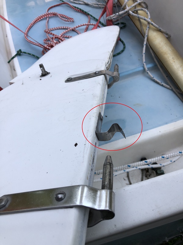

1. Pintles and Gudgeons - the rudder seems to be an OEM O'Day rudder assembly but there is a strange flat metal hook mounted on the leading edge of the rudder between the two pintles. Not sure what it’s for but it seems to touch the hull when mounted and seems to have worn its way through the gelcoat. My initial instinct was to remove the part but wanted to make sure I wasn’t missing anything
"Hook" between pintles on rudder

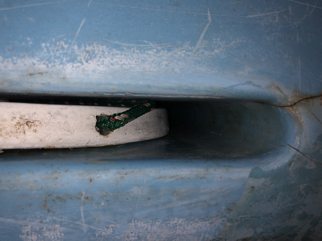

2. Centerboard Downhaul – the centerboard downhaul (green line) seems to have worked its way between the centerboard and the wall of the cb trunk. There doesn’t appear to be a visible track for the downhaul to ride in and, given the line thickness, this would seem a common occurrence. What is the best way to address this, would a thicker line help? How does the line even attach inside the CB?
Fouled CB downhaul

The metal piece between the pintles doesn't look stock. My best guess is that it's a spring designed to create side force on the pintles so they don't pop out of the gudgeons. One of my pintles has a small hole through it that allows for a clip to be installed to do the same thing.

The line falling down between the centerboard and the trunk is also a common problem. The centerboard line arrangement went through several revisions over the years, without - in my humble opinion - ever producing a trouble-free system. Later models, like my 1980, used a piece of shock cord in the line system to place tension on the line to keep it from falling down.
I'm away from the boat for a couple of days so I'm winging it from memory. I can supply more details on the centerboard next week.

Safety device: rudder catch
Postby GreenLake » Thu Sep 05, 2019 4:46 pm
The flat metal piece looks like a damaged rudder catch (or whatever the correct name is for that piece)
That is a safety device that prevents the rudder from falling out in a capsize or other sudden movement of the boat (so you are not relying entirely on gravity).
It's a flat strip of metal that is slightly bent (160-170° angle) so it rests against the inside of the pintle and, as the rudder is raised pushes against the gudgeon, preventing the rudder from being pulled out w/o it being depressed.
Alan is right in that it doesn't look like the stock part: from the photo, my guess is that somebody violently ripped the rudder out without releasing the catch; I've seen that happen, and they look approximately like that afterwards.
You can make a replacement from a strip of stainless steel, or purchase it from anyone selling sailboat parts. For my rudder-rebuild, I bought one from https://www.fisheriessupply.com/.

For the CB line issues, please read way back in this DSII section of the forum. The issue has been discussed multiple times and there are several solutions (I don't own a DSII myself, so I don't try to remember them, just know I've seen them).

2. I thought it could be some kind of rudder clip. It's angel is consistent w/ someone not knowing it was there and ripping it past the gudgeon. Should be easy to remove and bend back.
Opti sailers apparently refer to it as a Rudder Retaining Clip. It's function can be seen more clearly here: https://www.zimsailing.com/rudder-retainer-clip-opti.html
3. Seems like a critical design flaw on the early DSII's as I don't see how this doesn't "derail" every time. My initial inclination would be to either use a larger diameter line, file a groove into the leading edge of the CB, and some flat material on the leading edge to create a small channel for the line. Will read through some earlier posts first though.
