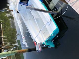

Thanks for the response , it seems to me that you completely understand what I have done so far. I'm attaching a picture for clarification.
The crossbar under the tiller has several functions , it supports my long tiller , I use it as a holding point for "locking" the tiller when on "autopilot" instead of the line that you put me onto a year ago and when I am really lazy I put a cushion against it and stretch out on the seat like a recliner, I can still see over the bow a bit.
The eyebolts (3/8" thread)go thru the crossbar , the deck and thru (2) 1 1/2 X 2 x 12 backing blocks.
The traveler should be far enough forward to minimize fouling the outboard when it is tilted all up.
I intend the tie a line from eyebolt to eyebolt for a "test" traveler and learn from that and will not limit myself to a fixed length , one end of the traveler could go thru the eyebolt to a jam cleat, I'll be learning as I go
I appreciate any advice you have and I'm not too worried about locating blocks , I don't buy much new but

That last foot or so of cockpit seating is where you normally don't need to / want to sit so the stern doesn't dig in and slow you down. Placing a traveler there would reduce the problems with tangling. So that's all fine. Exception would be running downwind in stronger winds, when you do want to sit aft, but not all of us tend to sail in those conditions. So both bar and traveler may well work for you as located.
I'm not sure what other info you are lacking to put this together. Perhaps, if necessary, draw your proposed setup in some detail. (If posting pictures, use a photo editor to compress the image, e.g. "medium" quality, rather than simply reducing the pixel dimensions. At 60%/medium you lose some finer detail, but less than what you lose by scaling to fewer pixels).
