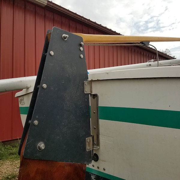

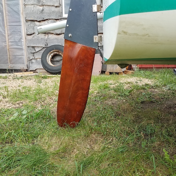

On the Dat Sailer II I got the rudder is not original. In comparing it to the drawing in Roger Conrads information-
Height from pivot to bottom of rudder 30", not 23"
Pivot to leading edge 8", not 6"
Leading edge to trailing edge 9.5", not 11 3/4"
Transom to pivot 10", not 9"
Pivot above bottom centerline 9", not 1"
The tiller is 5" above the transom
The boat sails well and comes about quickly. The main issue is that if you let go of the tiller , the boat goes to leeward. I am used to a boat going upwind.
What is most important to correct and where to start?

Lee helm: I would look to mast rake. Make sure that is set up to spec. (There's a North Sails tuning guide for the DS that gives a way to check that).
The rudder isn't the cause. Yours looks nice.

First of all your rudder.. if you are not holding it, then it has minimal effect on the boat's movement, as there is no force on it. So your Lee Helm problem is not your rudder. As GL wrote, it's a beautiful rudder and I wish it were allowed in the DS Racing Rules... High Aspect, deep, apparently with a NACA profile, with a sensible set of rudder cheeks and made of a beautiful wood. If you want to get fancy one day, apply a bit of what old-time bicycle racers used to call "Drillium".. Drill out some holes in the rudder cheeks to lighten them. Any weight you save at the rear, even if just a few pounds, contributes to better boat performance (see below).

You're quite welcome! If you ever want a race-legal rudder, I'll be happy to swap with you. :) All kidding aside, you've got the rudder that the Daysailer should have been designed with originally. Sailing theory was different in 1957 and now we're stuck with our slow barn-doors.....
