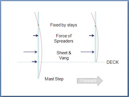

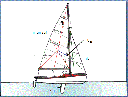

There are two things: location of center of effort, and mast bend.
Here's an image that shows the theoretical center of effort which needs to be balanced against the location of the center of lateral plane.
(See discussion here)
Any method of bringing the mast top back will change the location of effort.
However, if you can induce a mast bend, you will pull the middle of the luff forward (between head and tack). That will flatten the sail. This also changes the location of center of effort, because it will bring the actual location of maximum force on sail forward. (Like many things in sailing, you don't always get a clean single response to any adjustment, but some mix).
Mast bend for keel stepped and desk stepped mast
In a DS the spreaders are swept back and they push the mast forward a bit, so does the boom, especially with pull from the vang (the latter also causes a downward/rear pull on the main top via the leech tension, the two work together). If you have a vang, sight up the mast as you engage it.
If the mast is keel stepped the partners are just a point against which the mast is braced, they don't interrupt any mast bend. Tabernacles are not as efficient in making the mast act as if it was continuous. The picture looks more like the one to the right. That's the reason why racers don't cut their mast: they want to have the best control of mast bend.
The other fixed point is the hounds (where the stays meet and hold the mast in a relatively fixed position).
