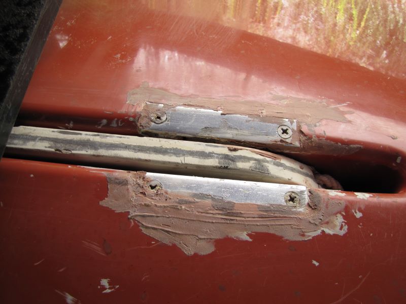

On my 1980 DSII, the centerboard retaining plates are attached to the bottom of the hull with flathead Phillips machine screws, like so:
centerboard retaining plate screws resized.JPG (62.75 KiB) Viewed 18694 times
I believe the 1984 DSII is the same.
The upper ends of the screws are visible through the inspection ports in the cockpit floor just aft of the cuddy bulkhead. (I've got photos somewhere; if I find them I'll post them.) It looks to me like they thread directly into built-up fiberglass, and there's no visible backing plate.
It may be possible to reach in to the ports with a long flat screwdriver or similar and have one person apply downward pressure on the upper end of a screw while another person turns it counterclockwise from below.
By the way, the goop that looks like auto body filler was applied by a previous owner. My best guess is that he was trying to stop water leaking into the bilge. The water was actually coming from the centerboard uphaul line fitting (lots of posts about that problem on the forum).

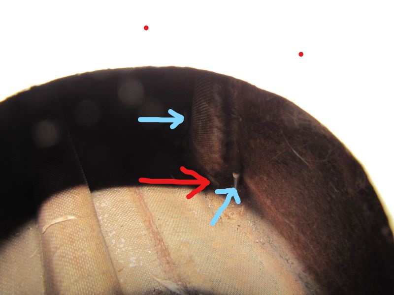

Found one of my photos, and you know, GL, it looks like you're right. Here's a view of the upper ends of the screws through the port-side inspection port:
centerboard retaining plate screws fom above resized.JPG (44.28 KiB) Viewed 18646 times
centerboard retaining plate screws fom above resized (2).jpg (88.78 KiB) Viewed 18646 times
The blue arrows in the second photo point to the screws. The red arrow points to one corner of what looks like a glassed-in backing plate.
If the backing plate is stripped out, I think you could install a nut and washer on the upper end of each screw. Working conditions would be a bit awkward, but it does look doable.
