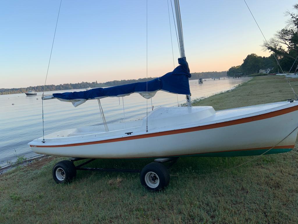

I just bought a 1979 16 feet ODay, this is my first sailboat. I have sail the ODay 4 times this summer and now is time to put it back behind my garage. I do not have idea how to step down the mast. My Oday mast go all the way to the keel. Could you please through some light?

I'd best let GreenLake answer here, but lowering this mast is relatively easy. As long as it's on land, preferably up on a well-secured trailer.
First thing to know, the mast weighs all of 40 pounds. If you can lift a medium-sized dog, you can lift the mast. The only problem is that it's 22 feet long, so a lot of moment arm (lever action!) if you pick it up wrong or if you let it start swinging while not in control. So the trick to lower it while maintaining control at all times. Greenlake will, I hope, give you the exact details, but in principle, you need to:
1) Take the boom and mainsail off
2) Detach the heel of the mast from the keelson (should be a bolt down there somewhere?)
3) Detach all three stays from their deck fittings
4) Stand up on the cuddy, straddling the mast.
5) Pull up on the mast till the heel clears the cuddy top. Do not let it swing! Use both hands, spread well apart
6) Swing the butt of the mast over clear of the boat to either side, and lower it straight down to the ground. You'll need a helper to hold it while on the ground. The mast should stay vertical at all times.
7) Hop down to the ground and walk the mast back down to horizontal. Have your helper control the butt of the mast so that it doesn't go flying as you walk the mast down.
That's it. But read what GL has to say. Bottom line, the mast is light but long, don't let it swing out of control.

I got my 7 feet tall with long arms neighbor help me. DONE
