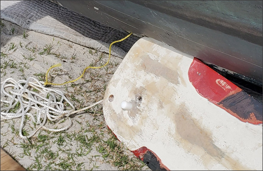

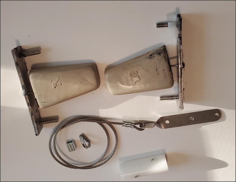

Four months have passed and I am ready to get this thing put back together. I am now tasked with measuring the centerboard to be sure I place and drill the hole where the pivot goes, and placing the connection for the cables to raise and lower the c/b. What's disturbing me at this very moment is that I am not sure I have the entire kit from DRMarine in front of me. Here's their photo of the DS II/III c/b kit, and the collection of parts I have. I only have one metal strap! And interestingly their photo doesn't show the pivot, which was part of the kit. So either I managed to lose a part over the winter or they neglected to include it. Ouch. Anyway, I am off to visit my boat, tip it over and do some measuring.
Regarding the pivot, I believe the best answer to secure it to the c/b is using epoxy or fiberglass resin to glue it in. The c/b pivots on top of the two inserts (in the pics on the table, and in the boat) so there's no reason that I can see for the pivot to rotate INSIDE the c/b.

Postby GreenLake » Wed Apr 21, 2021 9:21 am
I wish I had something constructive to tell you, but the pivot setup w/ wedges is something that I only know from reading about it here over the years. If you're short a part, definitely discuss your options w/ Rudy, although, if it's just a metal strip, you may be able to source your own.

I spoke to Rudy at DRMarine. Amazingly, he remembered a conversation I had with him back in December. It seems that the DS3 C/B only needs one metal cable - for the uphaul. So it's all good.

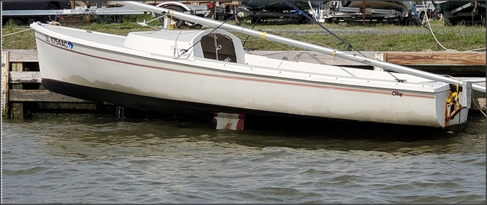

SUCCESS with the install of the donated centerboard (thanks again John). I installed the hardware (the cable assembly from DRMarine and a line for the downhaul) at home. This involved drilling two 1" diameter holes in the DS1 board and filling in the existing square hole. Unnerving but it seems I calculated the correct spots for them. I installed the CB at my sailing assoc using the little crane to tip the boat as usual. I set the metal cable for the uphaul on dry land but put the boat in the water to set and test the downhaul. I lifted the boat out of the water just a bit to confirm that the CB was sitting where it should when the downhaul line was pulled. It was - see the pic!
Though I will be sailing with this CB for a little while, I felt I had to order a new one anyway. This board is "soft" in the center area - you can press down and get about 1/4" or more of "give". It is solid around the edges and near the holes. It ought to hold up until I can replace it but I am concerned it will give out someday if I do not.
