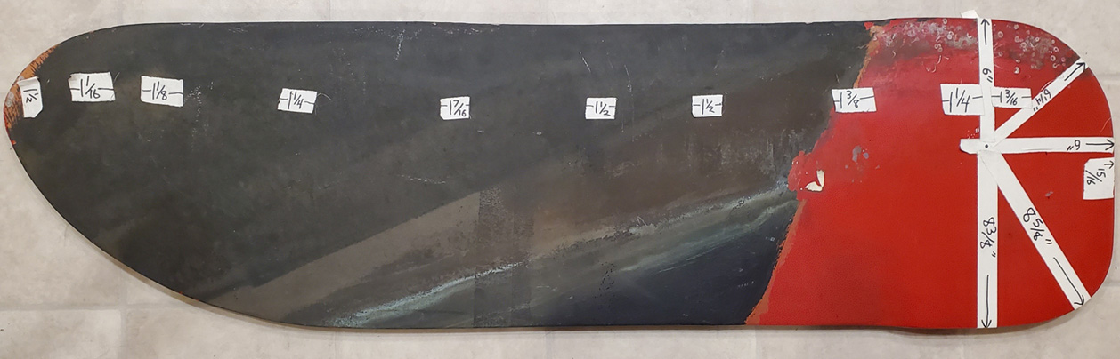

Postby SMichelsen » Sat Nov 28, 2020 11:11 pm
OK, I have received the centerboard from John. I took a little video of the underside of my DSIII, pondering the install process. Here it is: https://youtu.be/hW-TdyD7C6c
I had planned to rebuild the raise/lower mechanism to work as a DS I would, with the handle rather than the cables and pulleys. I was talked out of it by a guy with a lot more experience than I at my sailing club. So then as I see it, the steps are to:
- Order and wait for the cabling and CB pivot pin from DSMarine.
http://www.drmarine.com/proddetail.asp?prod=DS106b
Once the parts arrive,
- Figure out where the hole needs to be on the CB, so that it sits squarely in the DSIII trunk
- install the cabling and pin to the CB
- remove the plates and blocks under the boat, install the CB, replace the plates and blocks.
That's the jist of it, at least. I BELIEVE I can calculate the spot the new hole needs to be (assuming the old hole won't just work) by measuring the distance to the top and front of the trunk from the location of the pin. Even better would be to have a schematic of the DSIII CB that lays out the dimensions...

Postby SMichelsen » Mon Nov 30, 2020 9:13 pm
I spoke to Rudy at DR Marine. He warned me that he thought that the centerboard trunk on the DSI is somewhat wider than that of the DSIII, so the DS I CB might be too wide to fit in the DSIII. I am beginning to believe he's right. Hopefully at worst, this means a sanding and refinishing job for me, to make what I have thinner. Please see the photo of the CB; I took some measurements of the widest part of the board. Also see this video wherein I peer up into the DSIII trunk from below, ruler in hand... Any thoughts are much appreciated.
Steve
By the way, pardon my ignorance but can you please confirm which side of the centerboard faces forward when going through the water? I -- THINK -- it is what is seen as the top in the picture; is that correct? If so then the CB rides in the trunk the same orientation as in the picture, yes? Also, the measurements are taped to the CB at the thickest part.
Watch the video under the boat here
DS_I_centerboard v2.jpg (155.46 KiB) Viewed 32970 times
EDIT: I see now that the flat edge is DOWN when installed. I checked my crane video and there was the answer.
This is good, as most of the taper is on the curved side, and should fit well into the tapered trunk. We shall see.

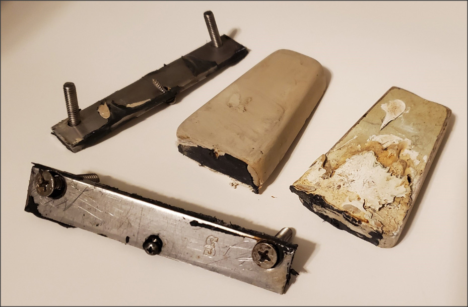

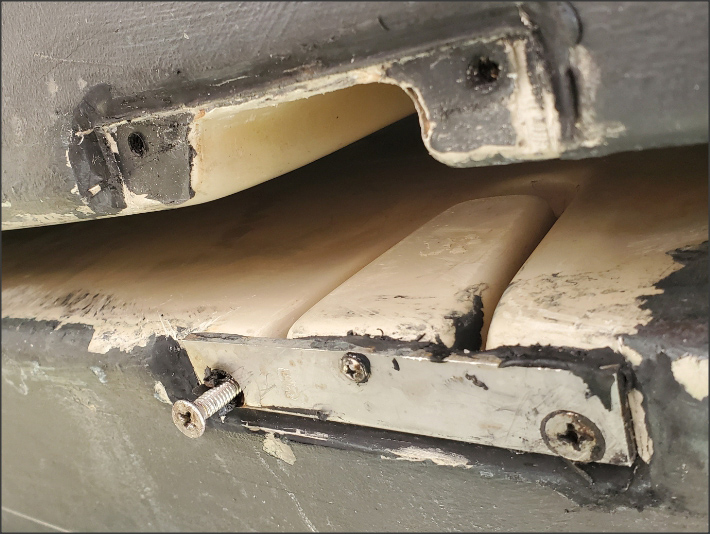

I had hoped to do a test fit of the DSI centerboard today, but there was only daylight enough left to remove the hardware that holds in (and holds up) the centerboard pin. The bars and supports were covered by all manner of caulks and waterproofing products - mostly unnecessary, and only made the job of removing it all that much harder. Tomorrow I plan to use the club's crane to lift the boat a few inches, move the trailer forward a few feet, place a sawhorse under the stern, and lower the crane JUST ENOUGH to stabilize the bow and stern on the trailer and sawhorse, while leaving space to access the trunk. This should reduce reliance on the lines holding up the boat.
Here's the bits, getting removed from the boat and out, waiting to be scraped clean.

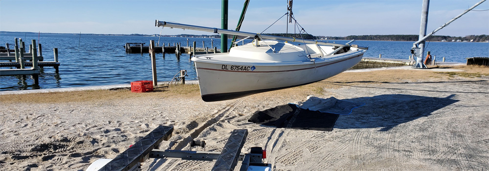

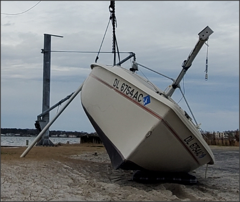

Here's today's update. I can now authoritatively say that a DS I centerboard does NOT fit into a DS II/III CB trunk.
I used my club's crane to set the boat on the ground, then tipped it on it's side to access the bottom. The picture of the CB shows how far it can fit in at this point. On the next nice day, I will set the boat up like this again, and bring along a belt sander and power planer, and flatten out the CB until it fits.
The boat held up by two of three lift points
also a post provided backup support
Here's how far the DS I centerboard fits. It needs to be flush with the hull.

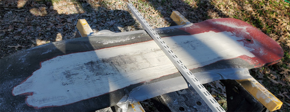

Postby SMichelsen » Sun Dec 13, 2020 10:34 pm

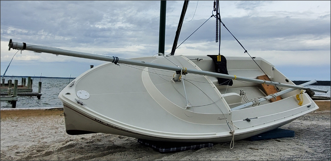

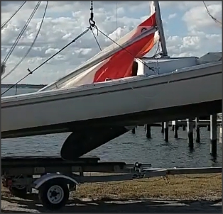

Today I shaved down the DSI centerboard to fit (with a tiny bit of slack) in my DSIII CB trunk. I believe I removed about 3/8" of thickness. I used a power planer and a belt sander. I cut MOSTLY through fiberglass but did go through to wood in a few spots. Can someone recommend a paint to seal and protect this CB? Please note that the boat does not live in the water, so exposure to the sea is limited to a few hours at a time. Here are a couple of pictures from today's adventures. I am still awaiting a delivery from DR Marine of CB hardware and cabling, at which point I will sort out a spot to drill a new hole in the CB and install it into the boat.
One awesome aspect of this project is having the run of my deserted sailing club - working on the boat at the edge of the water, making use of one of the two cranes for hours, was quite the luxury.

Postby GreenLake » Mon Dec 14, 2020 12:30 am
For sealing the wood use neat laminating epoxy. (Neat: as in unadulterated). You do want a vapor barrier - just make sure to seal the whole board, including the inside of any holes.
Simple as that. You do need to cover the epoxy from UV - for a CB that UV exposure is limited, but over the years some parts even of a retracted CB will accumulate enough exposure, unless your boat is garaged.
Almost any paint will do on top of epoxy, even cheap spray paint. Only problem is that most paint will be at risk of scraping off when you lower the CB. I believe if you used Pettits EasyPoxy (and let it cure for a weak or two) it would be tough enough to handle the stress. (I used some on the bottom of a silverware drawer and all the kitchen tools are thrown loose on the bare paint: it stood up to that test amazingly well, better than the cheap laminate surface that the furniture maker had been using).
