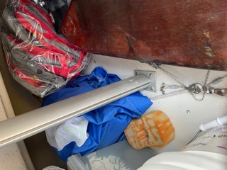

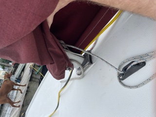

Soon to be new DS 3 owner here (and first time boat owner)! Hopefully going to pick her up next week, but as part of that process the previous owner indicated that he had never himself lowered the mast-- seems I'll be figuring out how to do that one on the fly.
Been poking around here for some guidance on how to do that, but unfortunately haven't been able to come up with anything my relative inexperience is able to make effective use of. If anyone has any guidance (or can point me to where other such instructions have been given), including any tools I would need, for what the process of derigging and lowering the mast on a 1990 DS 3 looks like, that would be much appreciated!
I'm including three pictures (2 within the cuddy, one up top) to help identify the sort of mast it is-- unsure whether it has a hinged mast or a tabernacle.

First, important to know, the mast weighs all of 40 pounds. If you can lift a medium-sized dog, you can lift the mast. The only problem is that it's 22 feet long, so a lot of moment arm (lever action!) if you pick it up wrong or if you let it start swinging while not in control. So the trick to lower it while maintaining control at all times. You have a tabernacle, which is the same thing as a hinged mast. It hinges at the cuddy top (aka on top of the roof), that double plate is the tabernacle itself. The tabernacle is just two plates attached to each other by two rods (fore and aft) which are themselves secured with wire pins - from the photo, I think you have cotter pins. There's many ways to do this, but here's what I would do:
