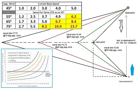

Postby talbot » Mon Dec 22, 2014 3:16 pm
Watching it rain, fretting about pending job proposals, can't even work on the boat, and this is what happens: Escape into pondering tack angles. We all know the boat goes faster if you fall off from close-hauled, but how much faster do you need to go to make it worth the longer tacks? I'm sure this is published someplace, but I put together my own display of how much speed you need to gain in a Day Sailer to keep your arrival time the same for each 10 degrees you fall off from apparent wind angle of 45 degrees. The table at the top of the image is what I plan to cut out and laminate for the boat. The highlighted cells indicate knots well above the DS theoretical hull speed (5.4kt). That is, if you are already going 5kt at 45 degrees into the wind, you would only gain an advantage in falling off if you could get the boat onto a plane. I trust that people will scramble to check my math, and I'll revise as needed. Higher resolution version available on request. Happy holidays!

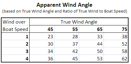

Your math is fine. I checked :) (You might want to put a slightly larger version of the graph with the curves. The legends aren't quite readable. :( )
But you are showing true wind, not apparent wind. Your calculation is based on the course over water (or, in the absence of current) also course over ground. So the angle you are describing is the angle against the wind as measured over the water (or true wind angle).
At different wind vs. boat speeds, the apparent wind angle that corresponds to a true wind of 45° would be different.
The relation between these angles depends on the ratio of the true wind speed to the boat speed. Here's what I calculated.
If the ratio of wind speed to boat speed were constant (for a given wind speed) then we could take this calculation, apply it to your table, and express things in terms of apparent wind (or what we see on the windex). It's not, so, things are a bit trickier. If we had the information (from a velocity prediction program, or from measurements) we would also be able to determine whether it's realistic to achieve the higher boat speeds needed at a larger angle.
For example, if 1.0 knots is the best I can get at 45° TWA for a given wind, is it realistic to get to 1.7 knots at a different point of sail? In other words, is a course of 65° ever realistic? What about 55° at 4.0 kn close hauled?
More generally, can we tell what wind ranges sailing any non-planing angle will get us there faster? These are interesting questions.
Same can be worked out for gybing angles, that is DDW versus reaching.
Using the TWA has the advantage that it can be approximated by compass headings. Not fully because of leeway. Assuming 5° of leeway, one would use your table for headings of 40° to 70° off the direct course to an up-wind target. Perhaps I'll try to measure some actual speed ratios for these angles.

Thanks for the clarification of apparent and true wind. That "simplified" article cited by K.C. is something it will take me a while to work through. So glad I don't have to read the unsimplified article.
I didn't put the chart in full size because, as Greenlake and KC pointed out, the continuous functions are really too precise for our needs. In practice, the only change we are likely to make is falling off 10 degrees or less from close hauled (i.e., the first line of the table is the most important one).
I will start next season with the rule of thumb that when my compass shows me falling off 10 degrees from close-hauled, I want to see the GPS pop up 25% (e.g., from 4 to 5 knots). We'll see what happens. The local yacht clubs maintain an Olympic circle of bouys on our lake, which often has the wind out of the north, so I could actually sail a course just like my diagram.

Great discussion. I think the GPS is useful at those marginal transitions (such as trying to sail just a little too high), where the increase in speed from falling off a degree might be apparent to the satellites before you feel it through the cockpit coaming. Yeah, 10 degrees is probably too big in increment. 5 degrees would be more realistic, and is the smallest gradation on my steering compass.
I think my chart might also be a motivator in situations where our boat handling is sub-optimal. For instance, if we are heeling more than 15 degrees close hauled, but can bring the boat down close to 10 degrees (either by steering or hiking), we very well could get the speed increases my chart requires.
I would imagine the easier a boat planes, the more sense it make to fall off. I understand that NZ took the early lead in San Francisco by realizing that foiling at lower tack angles was much faster than having any water contact with the hulls. Oracle had to fall off and beat NZ at its own game to win the cup.
