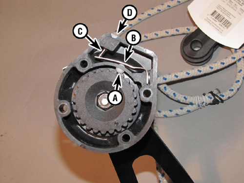

Postby Alan » Wed Oct 19, 2016 6:58 pm
Mainsheet swivel cleat bottom view.jpg (144.91 KiB) Viewed 33401 times
Above is a bottom view of the Ronstan RF7. The ratchet consists of a cogged disc and ball (A). Tension on the ratchet is supplied by a flat spring (B) and adjusted with a screw (C). Access to the screw is through a hole in the side of the base (D).
Mainsheet swivel cleat ratchet adjusting screw.jpg (166.57 KiB) Viewed 33401 times
The second photo is another view of the tension adjusting screw (D). The Ronstan website shows an Allen wrench (I have a slotted adjusting screw, not an Allen). The adjusting hole is also shown in a slightly different location in the base than what I've got.

Postby GreenLake » Thu Oct 20, 2016 12:47 am
Wow. What service!
Seems weird somehow to have ball bearings to reduce friction and then to reintroduce it via this "ratchet" mechanism.
The pictures make clear that it's not a one-directional ratchet. (In fact, it appears that the term "ratchet" may not be entirely accurate if it's not one-directional, but I'm no mechanical engineer, nor do I know what alternative term would apply).
Re: Playing the mainsheet with the stock block
Postby Alan » Thu Oct 20, 2016 1:17 pm
Haven't had a chance to play with Photoshop in a while. :)
I'm not a mechanical engineer either, but it might qualify as a cam wheel, since the rotary motion of the disc causes reciprocating motion of the ball.
I finally figured out why there's a ratchet/cam wheel/noisemaker. Ronstan says this: "Adjustable ratchet system prevents the arm from falling to leeward." I tried it with a jury-rigged mainsheet, holding it up in the air and tilting it to simulate heeling. With the tension released, the swivel arm does fall to leeward if there's any slack between the mainsheet blocks while the bitter end is held loosely by the crew. The mainsheet twists as it happens. Presumably, the mainsheet crew is sitting to windward at the time. Whether that would be a nuisance, or maybe a real problem, I can't tell without installing the setup and sailing with it, which ain't gonna happen soon, unfortunately.
