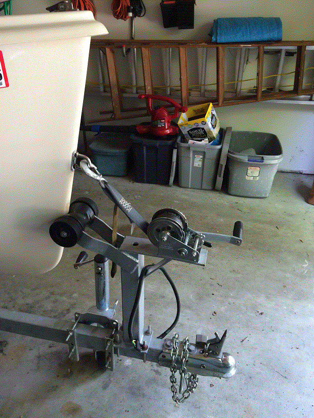

Postby KeithS » Sun May 24, 2015 8:29 pm
Here is a photo of my winch stand.
Here is a photo of the winch stand on my Venture VB1000 trailer.
IMG_1618 - Copy.gif (223.01 KiB) Viewed 267805 times

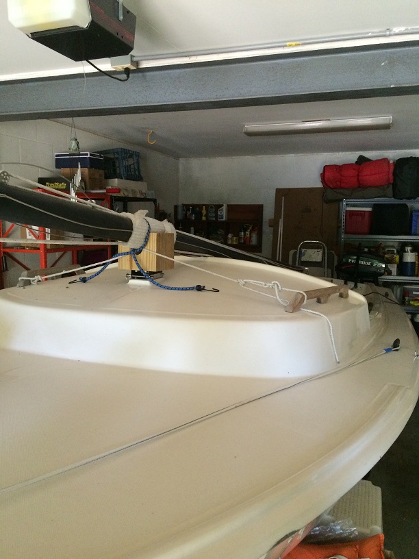

Re: Mast support while trailer towing
Postby KeithS » Sun May 24, 2015 8:34 pm
Here is a photo of the mast crutch block on the tabernacle.
IMG_1634 - Copy.JPG (147.13 KiB) Viewed 267805 times
Postby GreenLake » Sun May 24, 2015 9:10 pm
Keith,
off the top of my head I would suggest you could
  1. create a rear mast support from a 1x6 with a v notch on top and pintles to attach it to the boat
  2. make a front mast support as described below
  3. extend your middle support if you need the mast higher, if not leave it
Here's my suggestion for attaching a front mast support to your existing winch post.
  1. Get some 1x4s or even 1x3s
  2. fix them with hose clamps or U-bolts to either side of the vertical upright
    (The strap will pass between them, and if you use 1x4s then the handle should have enough offset to clear them)
  3. Use a bit of 2x4 that you attach between the two uprights, a bit down from their tops, so that the mast can rest on it and between the uprights
  4. add padding and provide some places to tie straps/bungees to
Depending on how tall you are making this contraption, add another bit of 2x4 partway up as strengthener. Again through-bolt this. (Or instead of a solid piece, just use several parallel strips of the same 1x that you used for the uprights -- just bolt the stack firmly together).
While it isn't solid, it should be quite strong enough for the purpose, as long as you retain the middle mast support as well. For that one, if you have any way to run a rope or strap to pull the mast down to keep it from bouncing up, that would be good; the angles your ropes have in the picture are rather shallow.
Anyway, that's just a quick suggestion. It kind of matches the mast support I built for another boat I have, not the DS, except in your case, attaching the bottom of it looks so much simpler with that nice upright you can clamp things to.
It goes without saying that anything you build from wood would need to be painted or varnished for protection. If you expoxy seal the wood, you can spray paint it the same color as the trailer -- or you can use house paint and touch it up frequently.
