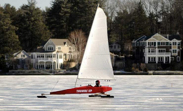

My iceboat hit a speed of 62 mph in about 15 mph wind last winter. The fully battened sail acts like the wing of a plane, but instead of lift it produces forward motion. The faster you go, the more wind travels over the sail and you go faster. If it wasn't for friction, I could hit warp one.

WoW that looks cool.

Roger- can you tell me the true wind and apparent wind angles when your traveling at that speed?

The telltales on my shrouds give me the apparent wind. I have to look at flags flying on shore to see the true wind. We sail an iceboat sheeted in tight to maintain a good foil shape and present a proper angle to the wind. But like any sailboat, our best point of sail is a reach. Like a catamaran, we tack downwind.

After rereading my answer to you, I don't think I answered your question. While there are people in the iceboating group who could give you an answer, I'm not sure. Since iceboats travel faster than the true wind all the time, the apparent wind angle does not seem to change on most points of sail. You would think you could sail straight into the true wind and on smooth ice, you can travel a long distance into the wind, but you eventually slow down. And downwind, when the speed of the boat matches the true wind, you almost come to a stop.
