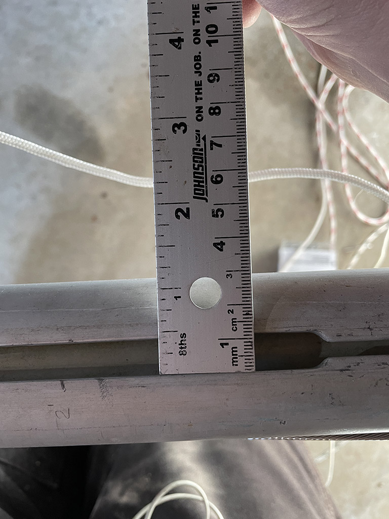

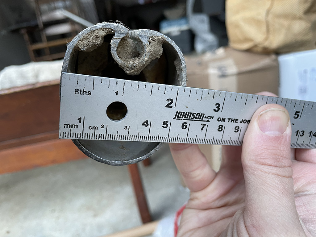

None of the hardware solutions I've tried seem to fit so far. Rig Rite asked me to try sliding the gooseneck from the base of the mast but the little neck before the tube did not quite fit, wasn't long enough to allow it to slide in. This method hadn't occurred to me but of course that makes sense if my opening is too small. I'm going to try it with my original gooseneck but I suspect it also won't fit.
Does anyone have or have info on this proctor mast? I'm just looking for anything. Selden has no info and I really just want basic hardware. The guys on the phone at Rig Rite are not particularly helpful. :(

I have a gooseneck that fits!
Lots of dremeling basically. Don't ask.
This particularly gooseneck has no loop for the downhaul. I was thinking of installing an aluminum loop on the boom pretty much where it meets the gooseneck and then tying that down to the downhaul cleat.
Any thoughts?
