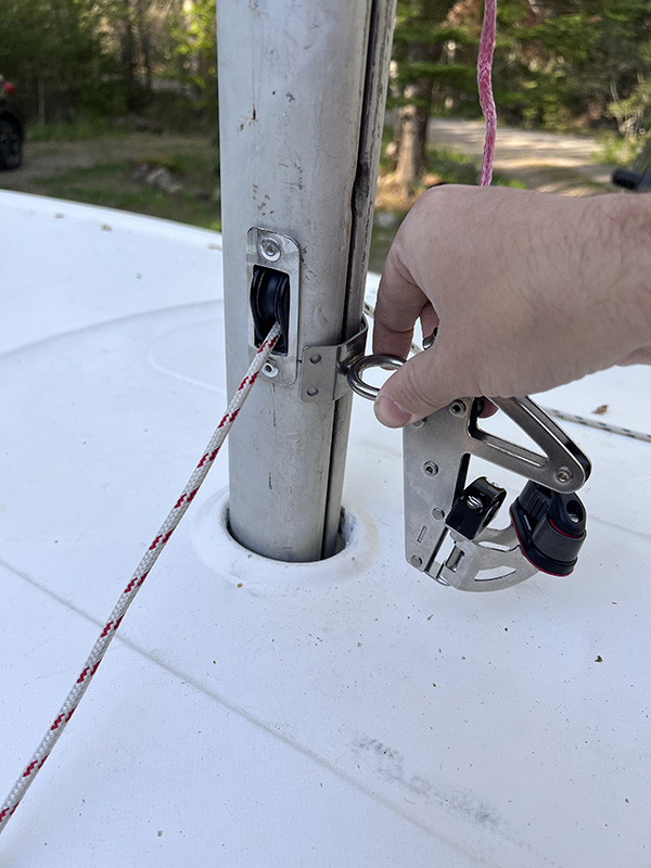

I just wanted to check with the brain trust on this positioning before I go drilling holes in my mast. This is just high enough to where it's not hitting the cuddy. The bail should be about 2ft from the mast?

The part isn't ideal for the application, because it looks like you might lose 3". One way to do that, is to attache the ring at the very bottom and then find a way to add a bit of a spacer. Whether a short bit of rope or some shackles. Just enough to let the part with the cleat come off the deck enough, but without compromising the already tight angle for the vang.
I don't have my boat accessible to give you a measurement along the boom, but you'll either find that in some old post, or by guessing it off one of the pictures.

I’ve seen some people run theirs “upside down” so to speak. I wonder if I could have the cleated part on the boom and the double block essentially where the mast meets the deck…

The range of adjustment for a vang is limited. That's why I think you could get away with adding a bit of a spacer - if your cleat can be tied or shackled into a line.

Yeah I mean now that I see that and the way I sail generally it seems like it would be harder for me to go farther forward to adjust the vang than having it closer to above the jib blocks. I think running it 'upside down' is making more sense to me.
For the shackles I was already thinking of using dyneema soft shackles. They seem flexible literally and figuratively for this purpose.
