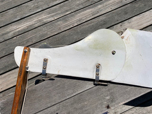

Postby RobH912 » Fri Jun 19, 2020 2:18 pm
Green Lake thanks for the reply and additional thoughts on EasyPoxy. If I do paint rudder I think I will use the WR-LPU white.
Have taken a closer look at the rudder and other than the forward edge of the foil, may not need to repaint. The leading edge still looks like epoxy over wood, looks sealed, it's just that paint has worn off leading edge. Sides of the rudder are not that smooth, and there has been some fairing done before.
I am going to first try a little scrubbing and then lightly 300+ grit wet sanding on the sides to see how rudder may clean up / smooth out.
Closer exception I have also found the Whale logo on one pintle, the entire rudder & tiller maybe original.
This rudder and tiller is heavy (20 lbs !), certainly much heavier than the SLI rudder and tiller.

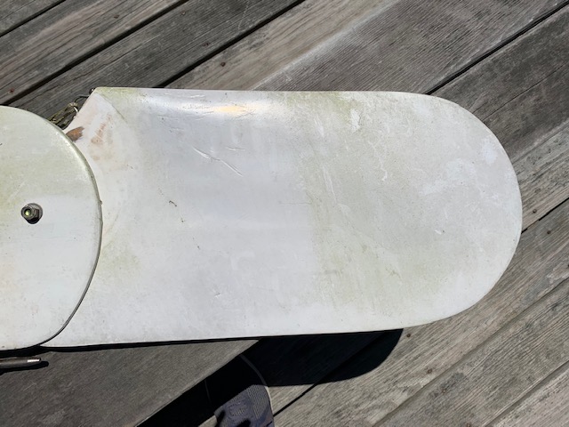

Postby RobH912 » Fri Jun 19, 2020 2:20 pm
one more picture

Postby GreenLake » Fri Jun 19, 2020 6:05 pm
That's an original rudder which would put doubts as to the presence of wood in the rudder blade. If it has been faired before, it might have been with epoxy with wood dust or a colored fairing compound.
That rudder has all the shortcomings that lead me tobuild a new one.

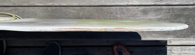

Postby RobH912 » Thu Jun 25, 2020 8:57 am
Green Lake - thanks for the additional thoughts on the rudder and your thoughts that it looked original. Had a couple more questions and some pictures as I started to clean up and lightly sand the rudder before painting.
What were the original rudders made of if not made of glassed over wood / plywood?
As I look closely at the leading edge of the foil where the paint & gel coat have worn down, I can clearly see what looks to me as the layered cross section of plywood, with a clear epoxy over the edge. It is hard to get a good picture. Went through a lot of the previous owner's posts on restoring # 2444, but see no mention of work or building a rudder for this boat. However I do see other posts where he is providing comments on building rudder or heads to others and that he built rudders & heads. May have used original hardware?
Once I gave the rudder a good scrubbing I did a light sanding with 320 grit paper as the surface still felt pretty rough, and then saw that the rudder has previously been painted. I could see some hardened drips.
I had mentioned earlier that I thought that there had been some fairing / filling done to the rudder, because I could feel that the surface had some ridges, and on one side a small bulge. There are two parallel ridges running top to bottom on both sides. When I started to sand the ridges and valleys are now easier to see, and when I get through the paint it looks like gel coat. Not sure what is causing the ridges but it is under the gel coat. See pictures below.
Not looking for perfect, but don't know if I should keep sanding off the gel coat to make the surfaces straight edge flat before painting with WR-LPU white or not. WDYT?

Postby GreenLake » Thu Jun 25, 2020 2:18 pm
The rudder (and CB) are the places where you really want a "perfect" surface. If necessary, you need to use epoxy fairing filler to smooth things out. You definitely do not want any grooves like the one on your picture.
Before painting, there's a limit to how high a grit number you should use. The paint will fill any sanding grooves of a certain size and if you sand too finely, you may make it harder for the paint to adhere. Some of the paints will tell you on the package, but I'd say that 320 is probably not bad for prep sanding. Once the paint is applied, you may sand lightly with a 1000 or 2000 grit, sometimes that works better than leaving the paint as is. (You definitely don't want any brush marks).
The better the surface, the better the rudder will work; there are limits due to the fact that yours doesn't look like it has a very good profile, but you still want to do everything you can to not disturb the flow.
