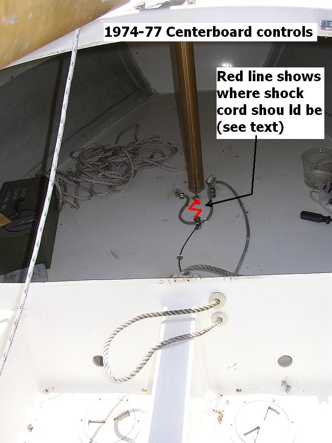

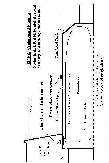

The DS II used at least 3 setups for the centerboard controls, 1971-74, 1974-76, and 1976-85. That is what my research has found and the diagrams and pictures are in the Expanded Owners Manual that i have created (with a bit of help from Rudy at D&R).
1974-76 version, used until October 1976.
1975_CB controls.jpg (72.23 KiB) Viewed 17400 times
I'll need to send another reply to add more pictures.
1973 picture
1973 CB down line.JPG (195.23 KiB) Viewed 17400 times
1971-74

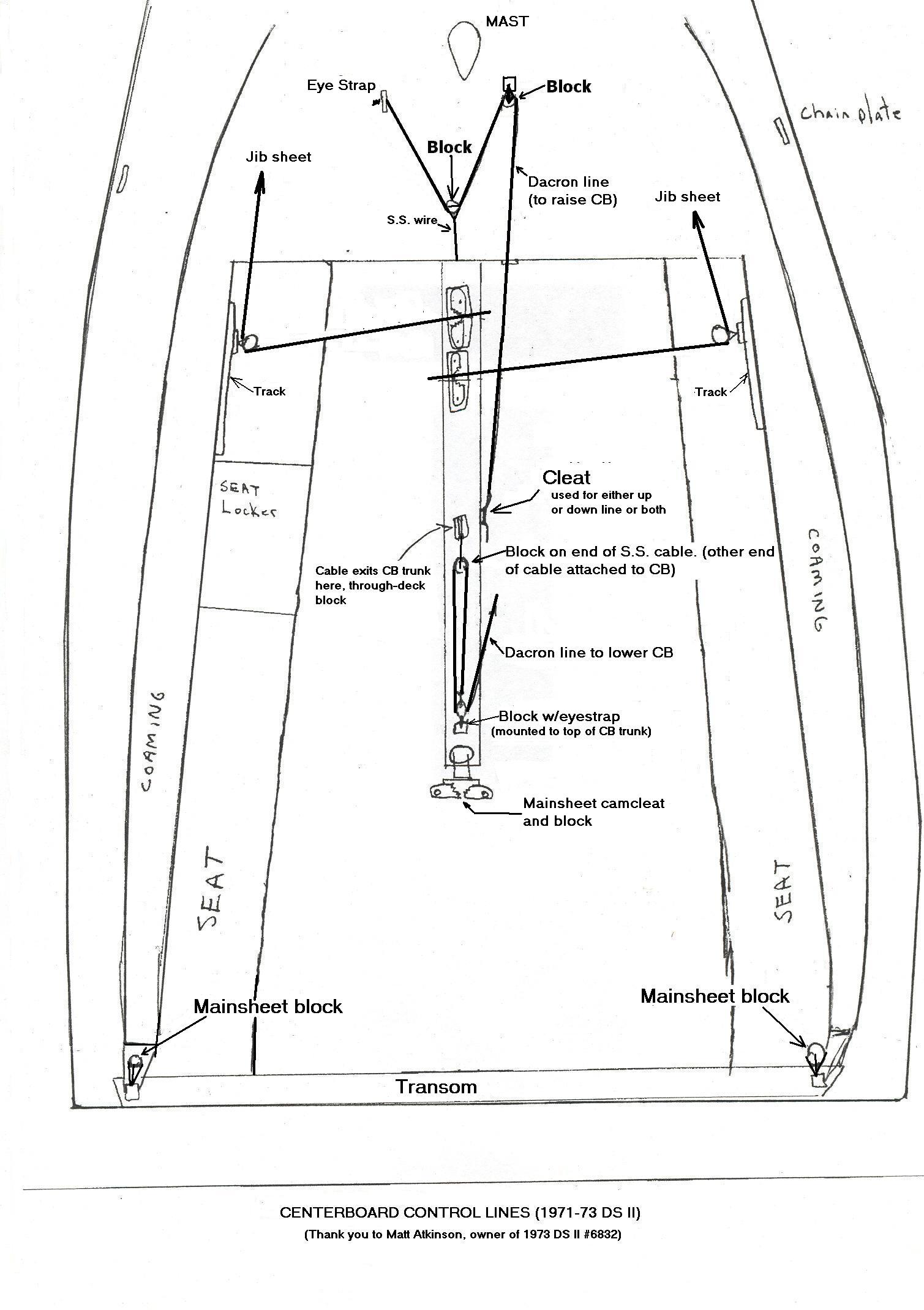

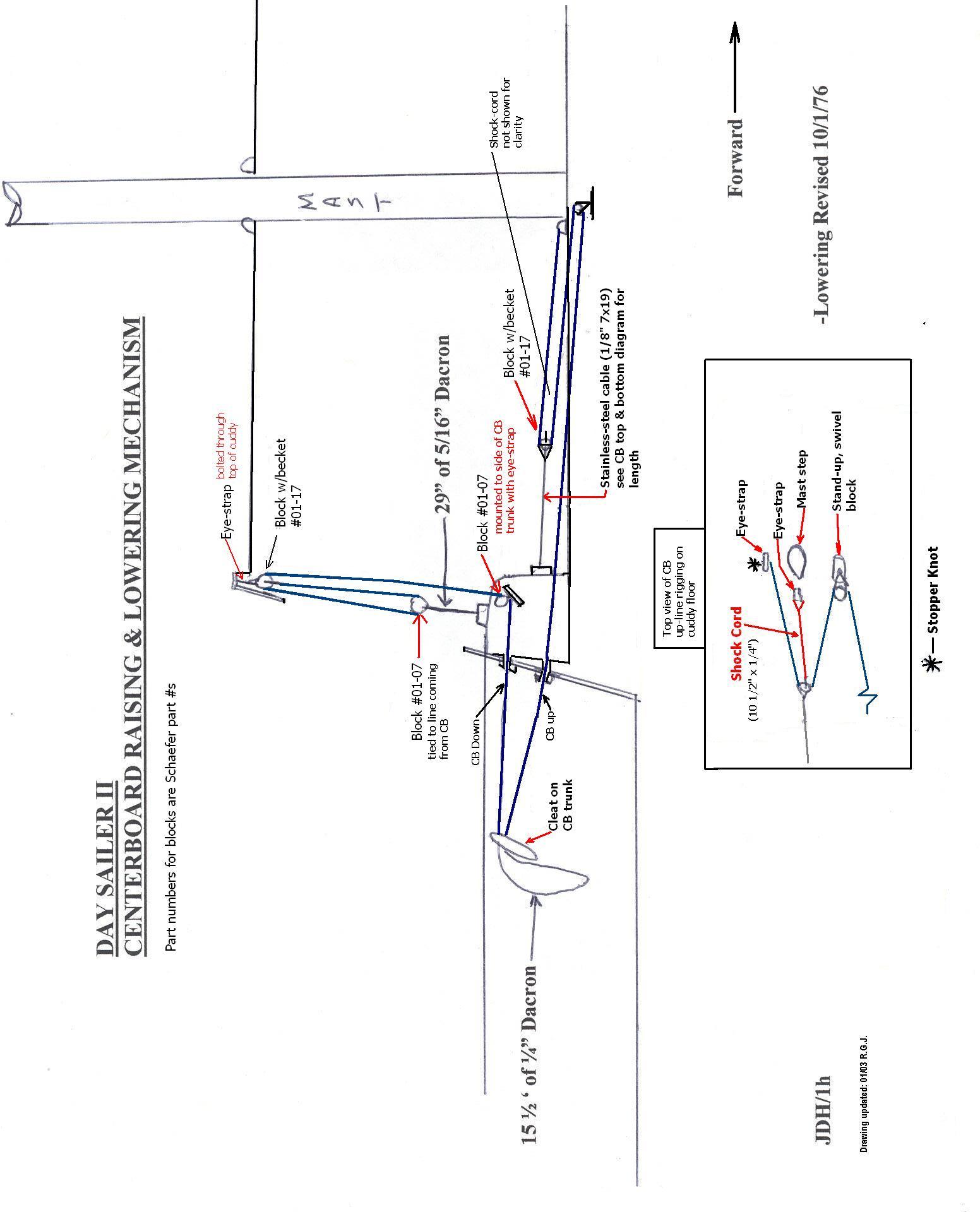

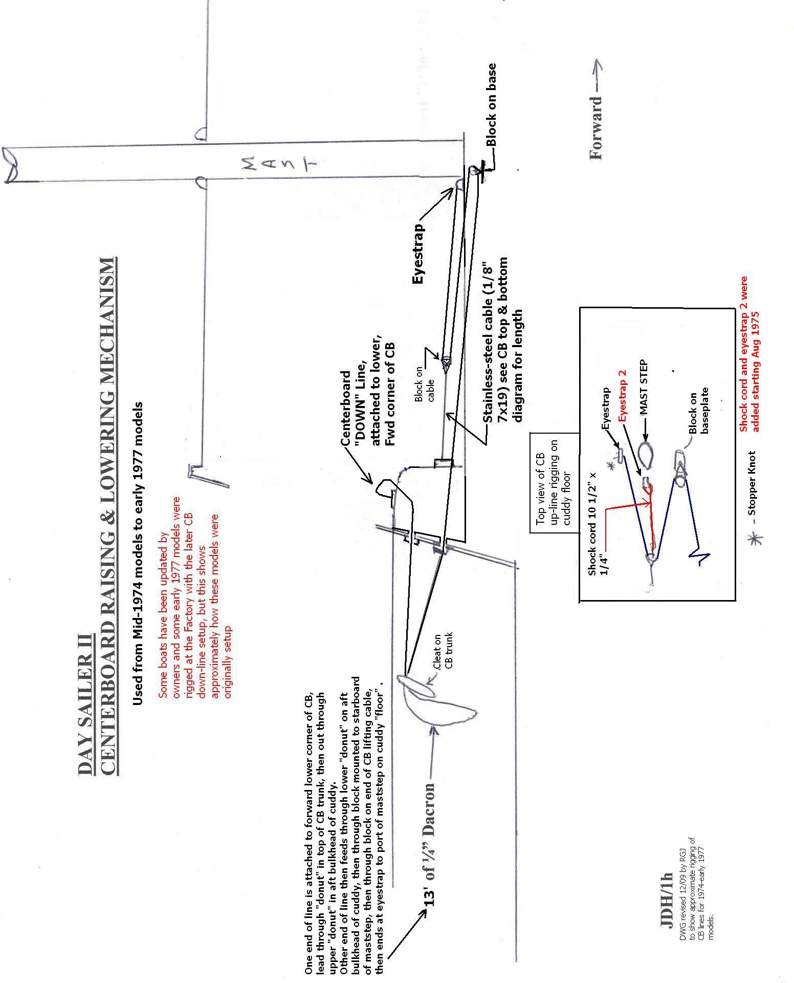

Diagrams: (I hope!)
Interestingly, Rudy was unaware of the 1974-76 version..... but I had an owner of a 1976 model tell me that neither diagram that I gave him matched his boat...... a little research lead to the revised drawing for those years and I made sure to get a copy to Rudy.
DS-II_cb dia.jpg (188.63 KiB) Viewed 17400 times
DS-II_cb1974-77 dia.jpg (231.48 KiB) Viewed 17400 times
DS II_CB draw_71-73.jpg (31.76 KiB) Viewed 17400 times

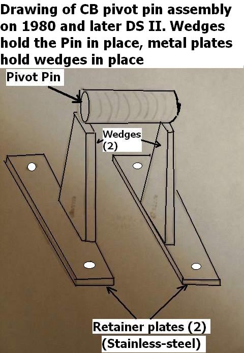

jdoorly wrote:Hi klb67 and welcome.
1419
Here is a pic of a DS2 CB layout, but other than that I'm not sure what year it represents. I have a 1973 DS2 and my CB downhaul exits out of the top of the CB trunk about where this pic shows the cam cleat bases. If my CB ever gets stuck I stick a 3/8" x 24" aluminum rod down thru the downhaul exit and push the CB out of the trunk.
That would be a 1980-85 vintage setup based on hte CB pivot pin being inserted from below and held in by a pair of wedges (virtually all O'DAY CBs were fitted that way at that time, except the Widgeon and Javelin).
CB-plates in place.jpg (51.58 KiB) Viewed 17400 times
CB_pivot assy dwg.JPG (54.31 KiB) Viewed 17400 times

Postby TIM WEBB » Mon Mar 24, 2014 10:07 pm
My '79 (XDY10099M79L-D) has the same arrangement as the cutaway drawing shows, but no wedges, just the through-bolt. Had the UH jam last Fall (my fault - was doing some testing of a possible "bungy DH system" - EPIC FAIL!), and found that I could access/replace both UH and DH lines with the boat careened, but w/o the need for CB removal. This much to my relief, as the CB bolt ends are covered in some kind of nuclear-winter-proof goop that makes CB removal impossible ...

Postby Alan » Tue Mar 25, 2014 12:11 pm
Speaking of centerboard leaks, a previous owner of my 1980 DSII (that's it in the photo of the1980-1985 centerboard wedges) apparently thought that the water getting into the bilge was leaking past the threads of the wedge bolts, and smeared on car body filler to seal them.
The wedge bolts aren't the source of the water in the bilge, at least on my boat.
The last two times I've sailed, the boat took on about eight inches of water in within a couple of hours of sailing. Overnight in the marina, it didn't take on any more water. I pumped it out, went sailing, and again had about eight inches of water in the bilge. I towed the boat home with water in in it. At home on the trailer, the water level in the bilge didn't drop at all and there wasn't any wetness around the wedge bolt threads.
All this leads me to believe that water is getting into the bilge through the notorious uphaul line holes, which are visible in the cutaway that jdoorly posted. There's a fix for that, which has been talked about on at least one other thread, and which is as the top of my to-do list before the next aadventure.
