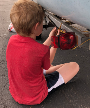

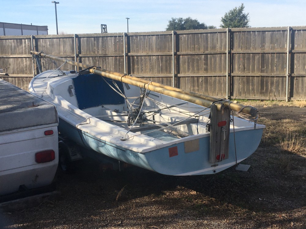

Finally got the boat out of the storage area.
We've had a lot of rain recently and the drain plug was clogged with leaves. So when we opened the gate, the bow was up in the air and the transom sitting on the ground from all the water weight in the cockpit :shock: .
First order of business was to replace a bad tire and replace the trailer wiring and lights, so we could drive home without getting pulled over.

Postby tomodda » Wed Mar 18, 2020 10:57 pm
Looks like you have a great helper!
Re: No Such Thing as a Free Boat
Postby daysailingDFW » Wed Mar 18, 2020 11:36 pm
tomodda wrote:Looks like you have a great helper!
Yep, he's super excited about "his" new boat :lol: .

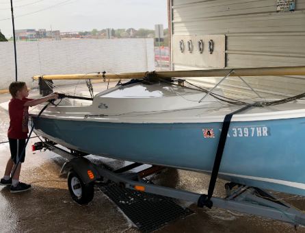

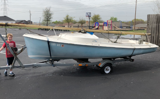

We stopped by the car wash on the way home. Layers of black grime were blasted away.

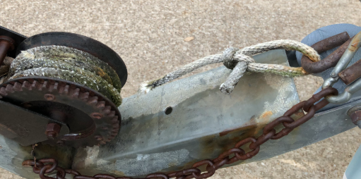

Last couple miles of the drive home I noticed the boat was bouncing on the trailer quite a bit. Once it was in the driveway, I realized the rotten trailer winch had broke at some point. Lucky it was secured well with straps and a safety chain!

daysailingDFW wrote:... I realized the rotten trailer winch had broke at some point. Lucky it was secured well with straps and a safety chain!
My recommendation for a replacement for the winch line/cable would be Amsteel (or any other Dyneema) which can be sized 1:1 in diameter to the wire cable the winch was designed for, or just a tad thicker for an extra reserve for abrasion/weathering. Dyneema's breaking strength is such that it will easily hold any loads during retrieval and is typically sold in a single braid that is super easy to splice (see Brummel splice).
The mechanical part of the winch may need a bit of restoration or anti corrosion treatment, but should be able to give many years of service.
