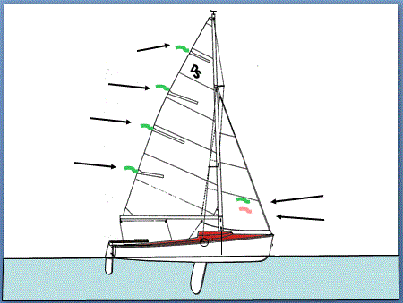

The most basic set of telltales is as shown in the picture:
- Telltales
- Telltales.gif (18.04 KiB) Viewed 47122 times
For the main, place one telltale per batten pocket at the leech. The goal is for all of them to stream happily aft, while the top one may flick forward part of the time. Especially on a reach you will notice that it makes a difference whether these are flying correctly or whether you have the main oversheeted or let out too far. If you have a vang, you should be able to see the telltales react as you adjust it. What the telltales indicate is that the airflow over the main has remained
attached all the way to the leech. It is this attached airflow that translates the wind force to your sails.
In all but light (except: very light) winds, you may need to tighten your
outhaul a bit to make the sail flat enough so the belly doesn't cause the air flow to separate. This should be something that you can observe in the right conditions with the lowest telltale (the outhaul acts mostly on the foot of the sail). In very light winds, you tighten the outhaul so that the flow stays attached. In light winds, you allow a belly to form to get a bit more power. In stronger winds you tighten the outhaul to flatten the sail to reduce power: at some point you already have more power than you need and the goal is to reduce heeling force.
For the jib, place one set of telltales of opposite color about 1/3 up and 18" from the luff on opposite sides of the sail. Usually, the starboard one would be green and it would be placed a bit above the port one. The goal is to see both of them streaming aft, but the windward one (in this picture the starboard one) is allowed to rise or flicker a bit. (That would indicate that the trim is for optimal upwind sailing.)
